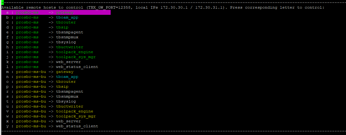

Log into your TelcoBridges unit with SSH and type 'tbx_cli_tools_remote' This should present you with the following screen, which is a list of applications running on this system.

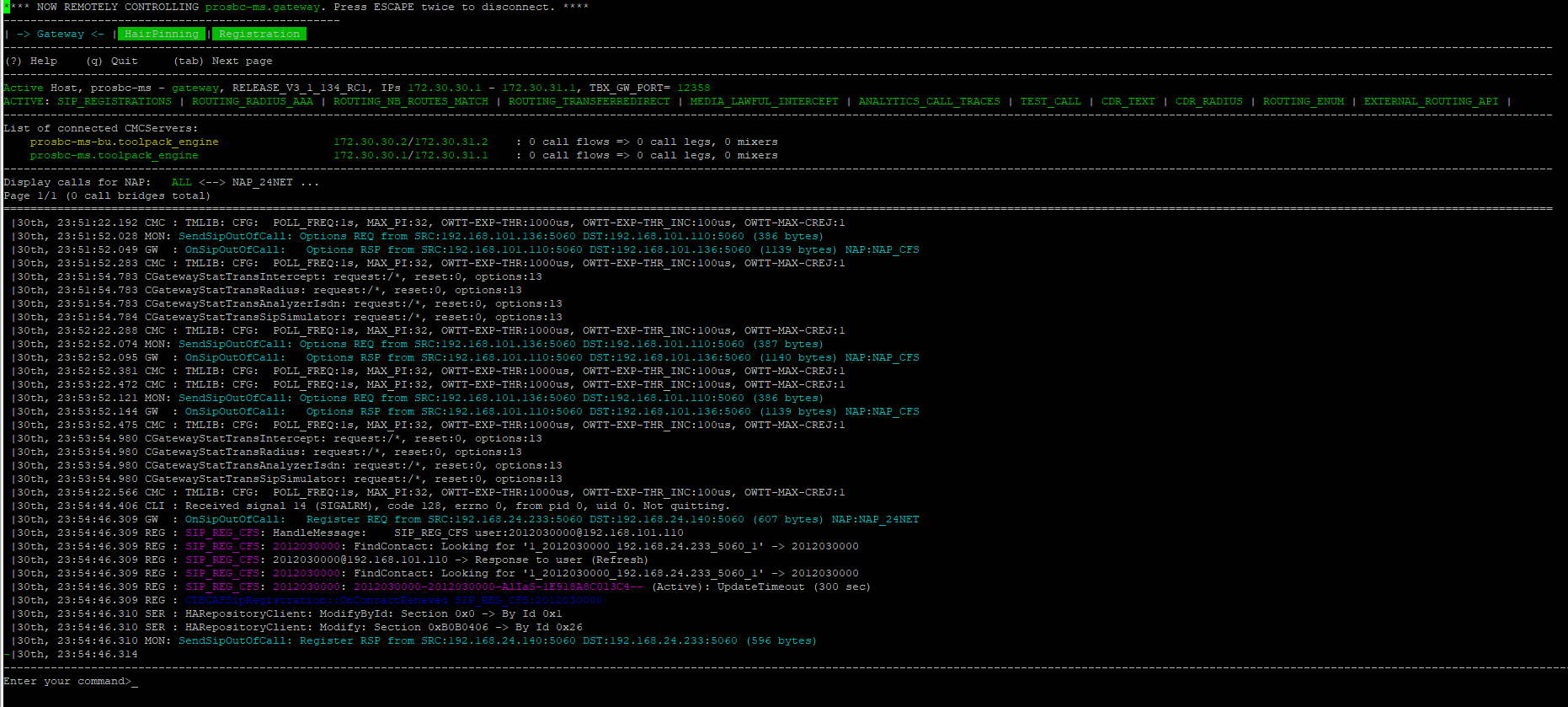

Select the application to open. (In our example we will use Gateway)

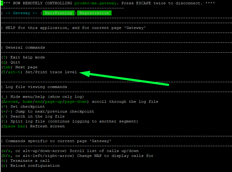

Every application will have a slightly different set of commands as there are some application specific functions. To see the available actions, press '?' at any time. For all applications the character 'T' will prompt you to enter a new trace level. Note the 'T' is capital, a lower-case 't' is assigned to a different action ex. Terminate Call in the 'gateway' application

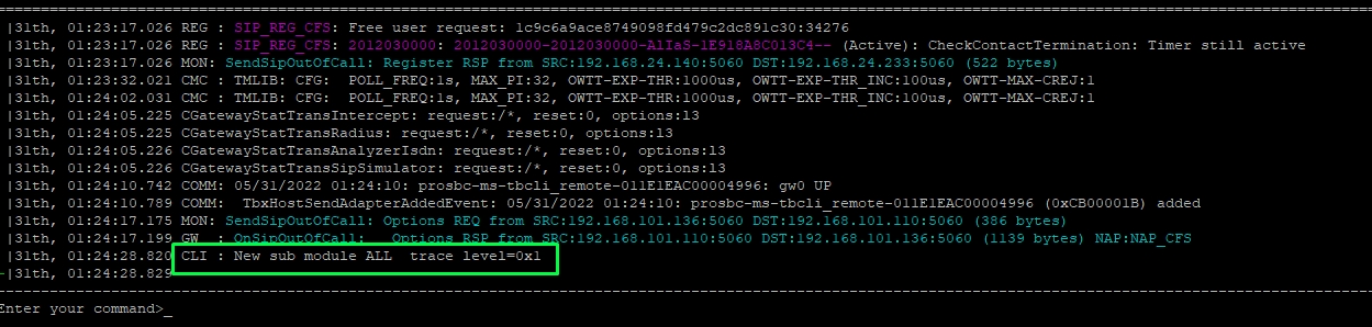

The application will show the current trace level in the format 0x3 where '3' is the current level.

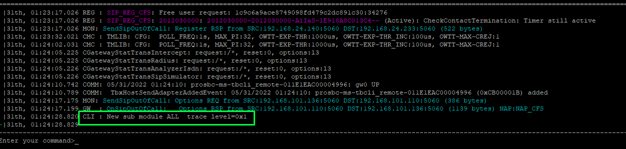

Disregard this formatting and type the desired level as a single integer.
Press "enter" and your change will be applied. You can check the logs for confirmation.
