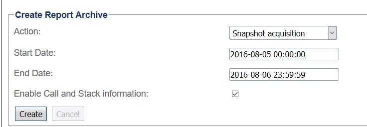

Select Report from the navigation menu.
Select the time range and click Create.

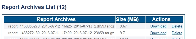

This will create a single file that can be downloaded for analysis and this can be sent to TelcoBridges:
