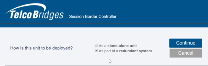

Go through the initial configuration and select "This unit is deployed as a stand-alone unit" If the configuration database is available, restore it on the system: Restoring Database Procedure for v2.8 and up Otherwise you will need to reconfigure the system: ProSBC Configuration
Replacement of a Primary ProSBC
Go through the initial configuration and select "As part of a redundant system"

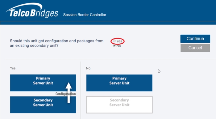

Then select "The primary unit"
and "Get configuration from an existing secondary unit"

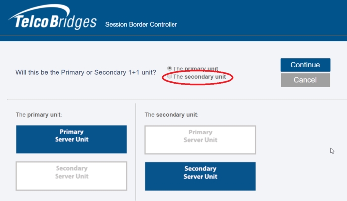

Replacement of a Secondary ProSBC
Go through the initial configuration and select "This unit is deployed as part of a redundant system" and select "The secondary unit". It will automatically get the configuration from the primary unit.
