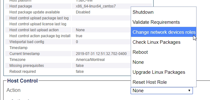

Once the ProSBC is configured, it is possible add or change physical IP interfaces. To do so you must reset the network device role settings of the unit. Note: this will reallocate the main network controller and stop the service for a few minutes
To reset the network device role, do the following:
1- Click Hosts in the navigation panel.
2- Select the serial number of the unit.
3- Click the Status tab.
4- In the Action drop down box select Change Network Devices Roles
  • Click Apply Action
