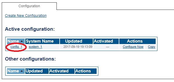

1- Click Configurations in the navigation panel
2- Select the desired configuration from the Active configuration list.

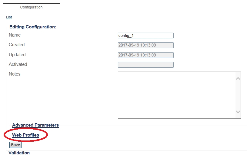

3- Click Web Profiles to modify the web portal profile..
4- Uncheck/clear any web portal options that you do not wish to see.
5- Click Save. The web portal option is immediately removed from the navigation panel.
