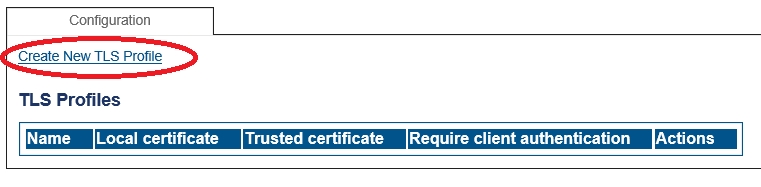

1. Select TLS Profiles from the navigation panel
2. Click Create New TLS Profile
3. Configure TLS Profile parameters

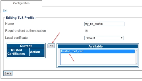

  • Provide a name that is meaningful to you.
  • Check if client authentication is required. Enabling this checkbox means that incoming connections require the remote side to present a or many trusted certificate(s) (later selected after creation).
  • Select a local certificate
    • Either one imported earlier (see Adding TLS Certificates), or the "Default" certificate which is automatically generated by Toolpack and is also used for HTTPS.
  • Select a Security Level (available since ProSBC version 3.3.5arrow-up-right)
    • See tooltip for details.
  • Click "Create"
  • Select one or multiple "trusted" certificates, only necessary if "Require peer authentication" is checked.
