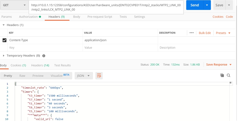

  • When sending HTTP requests to Telcobridges management interface for manipulating with Telcobridges configurations' resources, the HTTP request must be following the HTTP headers as listed above.
  • Out of these headers, besides Host information and Authorization, Content-Type is important, and must be specified as "application/json" in order to return right result
  • Other headers are either already complying or optional, and becoming less important when using default headers values as provided by Postman

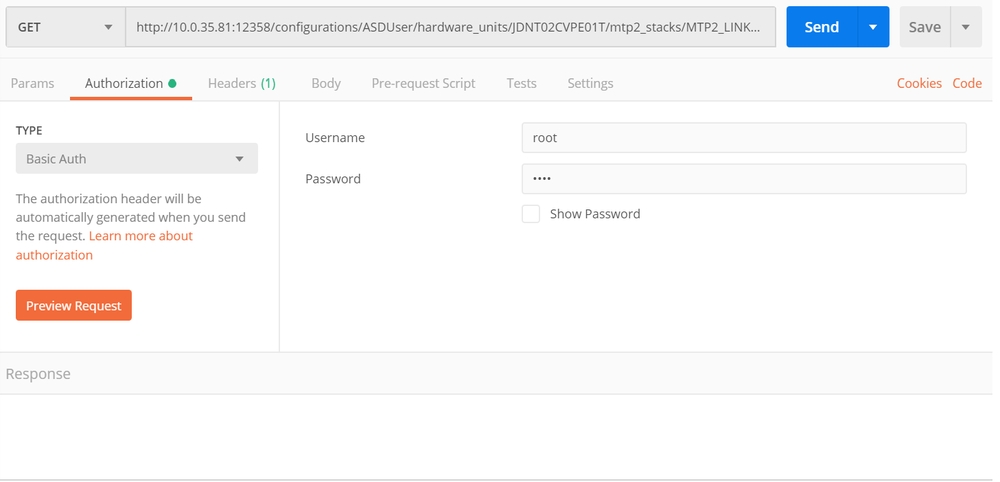

GET
Include the authorization with "Basic Auth",
Get the configuration collection list and display the JSON returned in the body of the HTTP response.

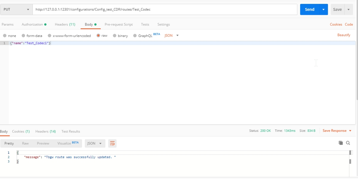

PUT
Modify attributes of an element. Below example renames the route element named "Test_Codec" to "Test_Codec1".
  • With the authorization and header set like GET
  • Specify the route name that will have name changed, in this case, "Test_Codec"
  • Go to "Body" tab, click "raw", and select "JSON"
  • Copy the new name parameter as {"name":"Test_Codec1"}
  • Press Send, and will receive 200OK

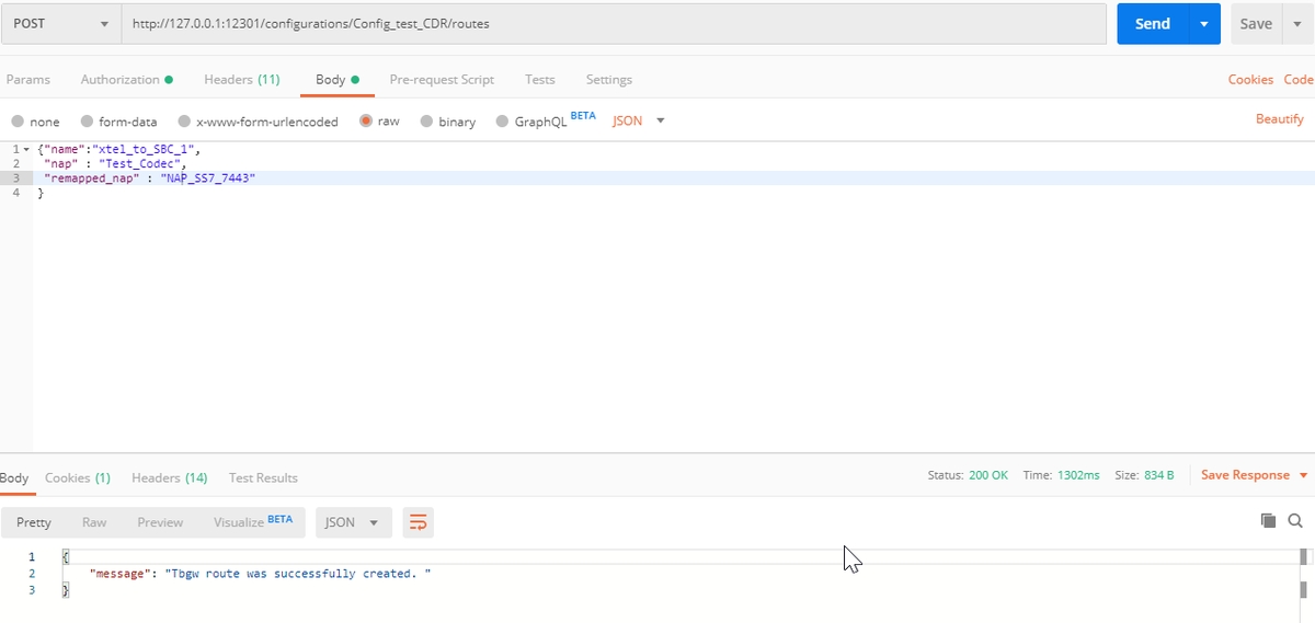

POST
Create a new element. Below example add a new route named "xtel_to_SBC_1".
  • Specify the route name to be added, in this case, "xtel_to_SBC_1"
  • Copy the new name parameter as {"name":"xtel_to_SBC_1","nap" : "Test_Codec","remapped_nap" : "NAP_SS7_7443"}

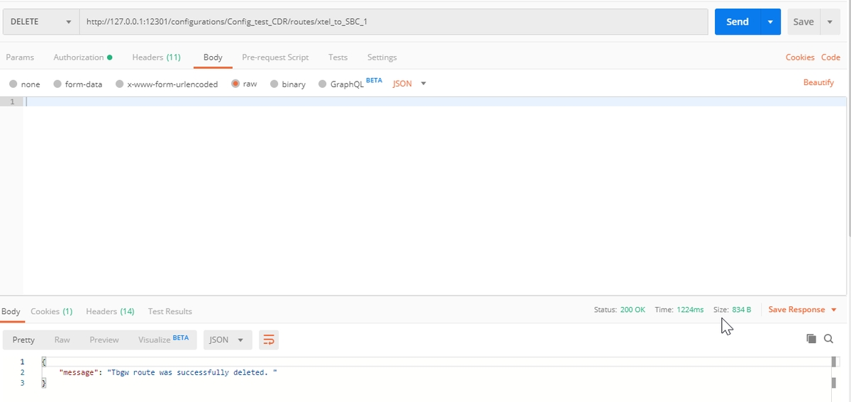

DELETE
Delete an element. Below example delete the route named "xtel_to_SBC_1".

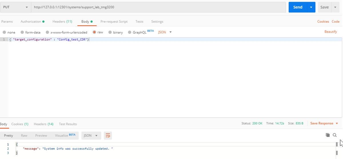

PUT (for activate configuration)
Activate a configuration. Below example is to put (thus activate configuration) for the configuration named "Config_test_CDR".
  • system name, in this case, is "support_lab_tmg3200"
