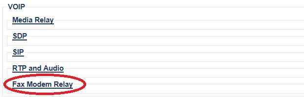

To configure FAX Relay settings, do the following:
1- Click Fax Relay in the Editing Profile window, to display the customizable options.

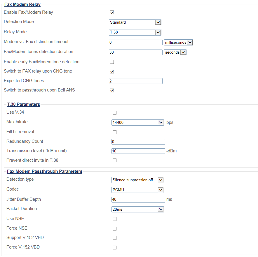

2- Modify settings as required.
3- To configure NSE, check the Use NSE checkbox.
NOTE:
If NSE exchange is possible (negociated in the SDP), the switch to passthrough will happen in the RTP stream and no longer wiil occur with a SIP re-INVITE. This implementation of NSE currently only supports a switch to passthrough, which means that you can have NSE packets switching to T.38.
Click Save
