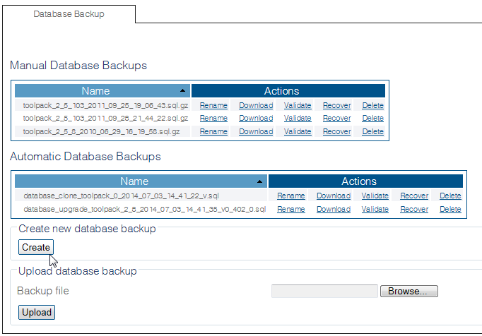

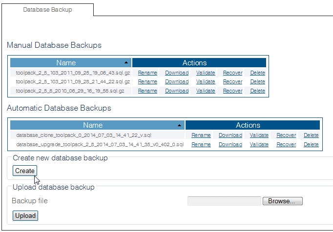

1- Click Backups in the navigation panel
2- Click Create (In the Create New Database Backup section)

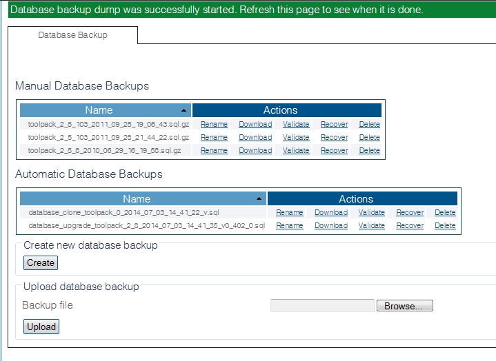

3- Verify that the Database backup dump was successfully started. Refresh this page when it is done message appears.
  • Refresh your Internet browser page

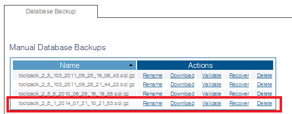

4- Verify that the new backup appears in the Manual Database Backups list.
