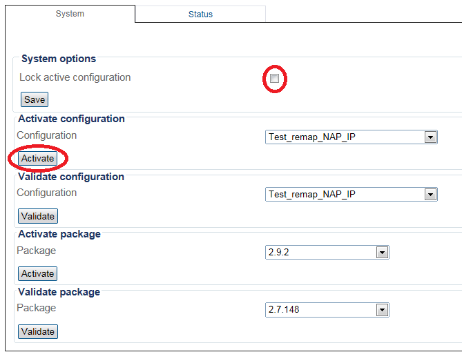

1. Select System from the navigation panel.
2. To activate the configuration, click Activate.
Note: Make certain that the Lock active configuration box is unchecked. Failure to do so will prevent the configuration from being saved.

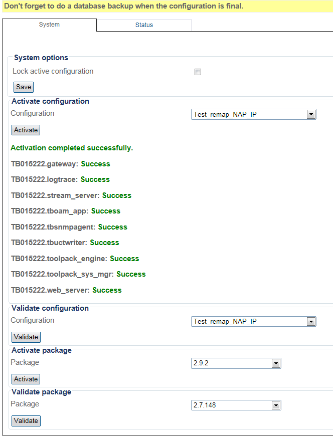

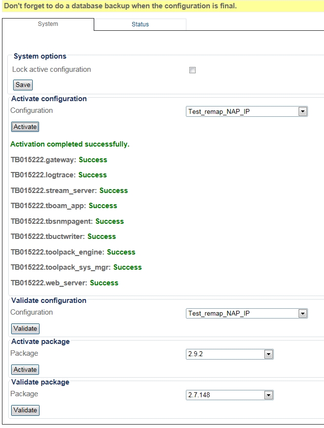

3. Verify that an activation confirmation message is displayed. The system will remind you to back up your database when you are done configuring (at top of screen):
