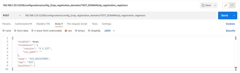

You can add a new SIP Domain Registrar with the POST command:
POST http://ProSBCIP:12358/configurations/configuration_name/sip_registration_domains/domainname/sip_registration_registrarsarrow-up-right
ProSBC will create a new SIP Domain Registrar from the name in the JSON file.
Example: We use the Postman tool in this example and the URL is:
http://192.168.1.25:12358/configurations/config_2/sip_registration_domains/TEST_DOMAIN/sip_registration_registrarsarrow-up-right
If the new SIP Domain Registrar is created successfully, the following message is returned in the Postman Tool

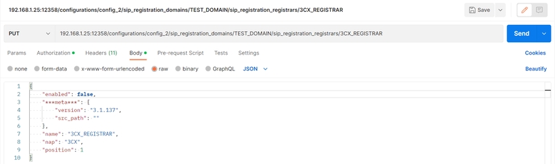

Modifiying a SIP Domain Registrar
You can modify the existing SIP Domain Registrar with the PUT command:
PUT http://ProSBCIP:12358/configurations/configurationname/sip_registration_domains/sip_domain_name/sip_registration_registrars/registrar_namearrow-up-right
192.168.1.25:12358/configurations/config_2/sip_registration_domains/TEST_DOMAIN/sip_registration_registrars/3CX_REGISTRAR and disable it
If the update is successful, the following message is returned in the Postman Tool
