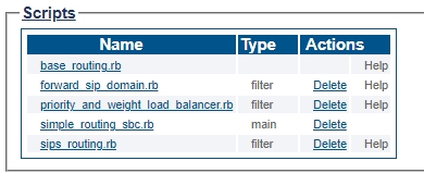

Then upload it in the system with these instructions: Import Customized Routing Script You can also copy/paste the content of the main file and create a new 'Main' Script using the Create New Script File menu
Setting up YouMail spam risk Scripts
To set up a Filter, the main script needs to be modified. The main script can be either simple_routing.rb, simple_routing_sbc.rb, or any other script with the 'Main' type.
Go to the routing script section of the Web portal
Three things need to be added. At the start of the script:
In the main class:
The final 'Main' script will look like this:
There may be other scripts called by this 'Main' script. This is normal.

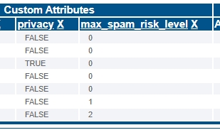

Adding New max_spam_risk_level Variable
You need to add a new custom column to use this script. There is a default value created and it can be changed in each route afterwards.
Name: max_spam_risk_level Type attributes: integer Default: 0
The result will look like this: You can then go in each route and change this value. '2' will be accept all calls, no matter what. '0' will be to accept only calls validated by YouMail.
