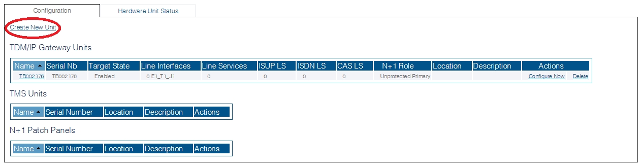

1- Click Hardware Units in the navigation panel
2- Click Create New Unit, to add a new hardware device

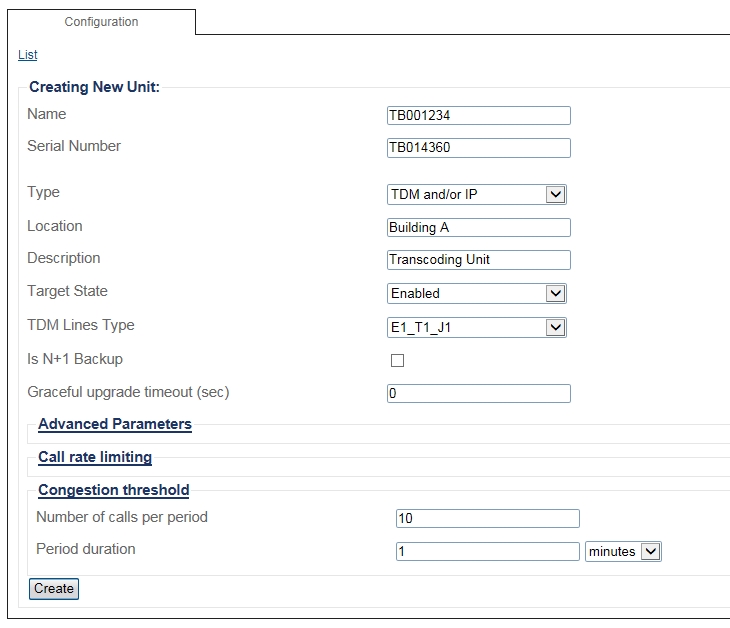

3- Enter information for the following parameters:
  • Enter a name for the hardware device
  • Enter the serial number of the new hardware device (filling in the Serial Number field will cause auto-completion of the field to occur).
  • Select TDM and/or IP from the Type field.
  • Enter the location in which the hardware device is installed.
  • Enter a meaningful description about the use or purpose of the hardware device.
  • Select Enabled from the Target State field.
  • Select the type of TDM lines that the hardware device will support.
  • Leave the Is N+1 Backup field empty.
  • Provide the amount of time in seconds, that the system will wait for calls to complete before shutting down for an upgrade.
  • Click Create

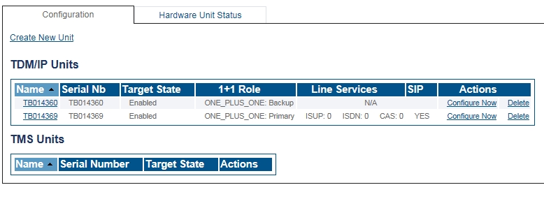

4- Verify that the Unit was successfully created message appears, and that the newly added hardware device appears in the Hardware List.
