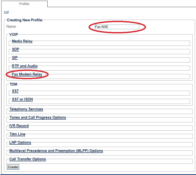

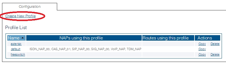

1. Select Profiles from the navigation menu.
2. Click Create New Profile
3. Enter a name for the Fax Profile.
Click Fax/Modem Relay to expand the view.

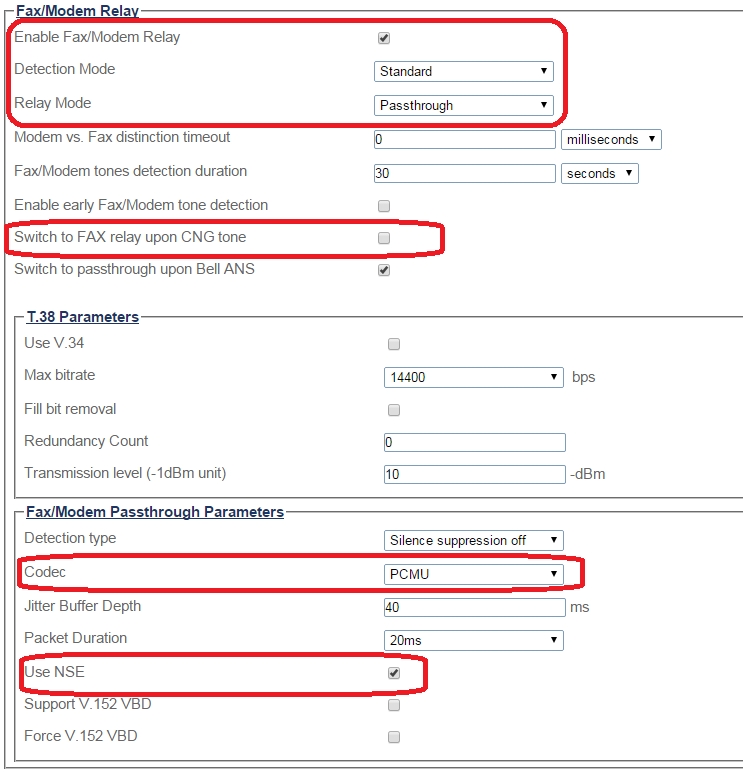

4. Configure the settings:
Set Enable Fax/Modem Relay to enabled.
Set Detection Mode to Standard.
Set Relay Mode to Passthrough.
Select a codec. For example silence suppression
Set Use NSE to enabled
5. Verify that the Profile was successfully created message is displayed.
