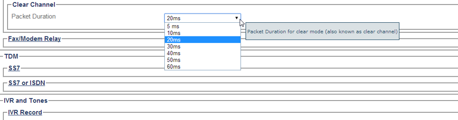

If you want to use a packetization time different from 20ms, you have to go Profile->RTP and Audio->Clear Channel.
And this will result in a SDP like:
m=audio 0 RTP/AVP 96
a=rtpmap:96 CLEARMODE/8000
a=ptime:10
