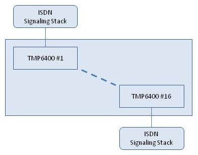

Tmedia and Tdev systems can be configured to provide an ISDN signalling stack on the trunks of one or more units to meet system configuration requirements. ISDN signaling stacks are signaling resources that are assigned to a specific line of the Tmedia or Tdev unit. Based on the Q.931arrow-up-right switch variant that will be used by the system, a selection of ISDN variants are available. For each line service requiring ISDN signaling, an ISDN signaling stack is created with its own distinct signaling variant.
Note: The trunks of each Tmedia or Tdev unit can be configured to have their own ISDN signaling stack.
