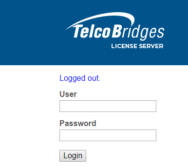

Connecting to the License Server
1- Use the following URL to reach the TelcoBridges License Server: https://licenses.telcobridges.comarrow-up-right
  • A Login window is displayed.
2- Enter your login credentials.
  • Click Login

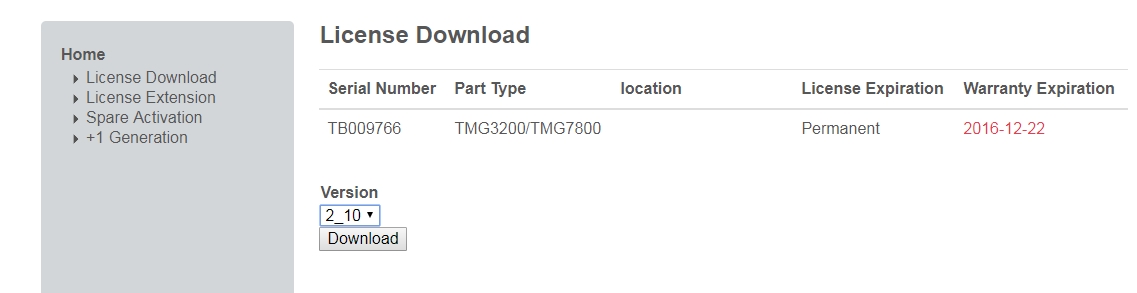

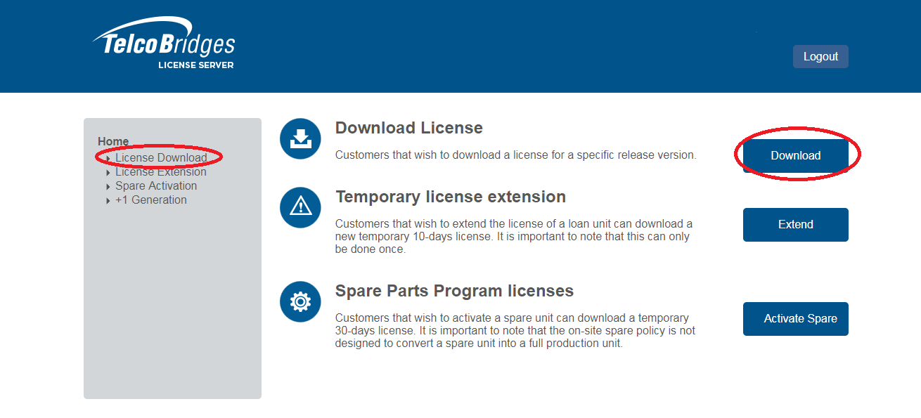

Downloading a License

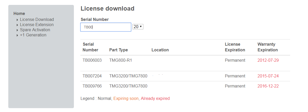

1- Either click License Download or the Download button.
2- Enter the Serial number of your device.
  • Select your device from the list.
3- Select your Version from the drop down menu
  • Click Download

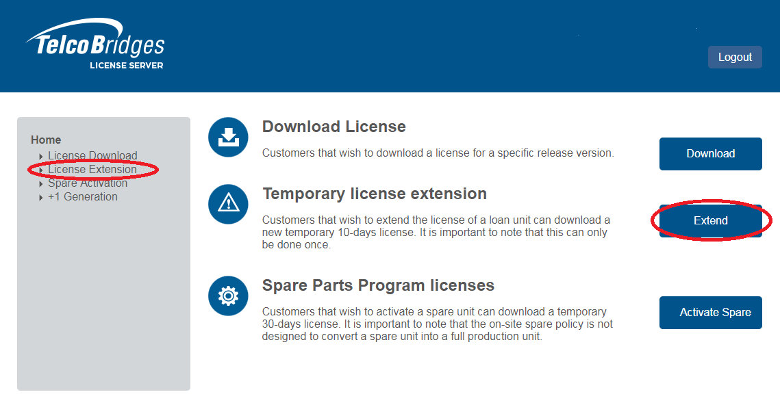

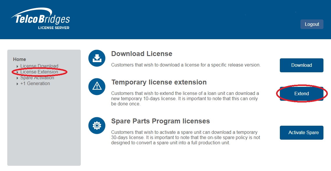

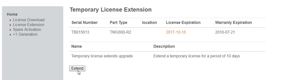

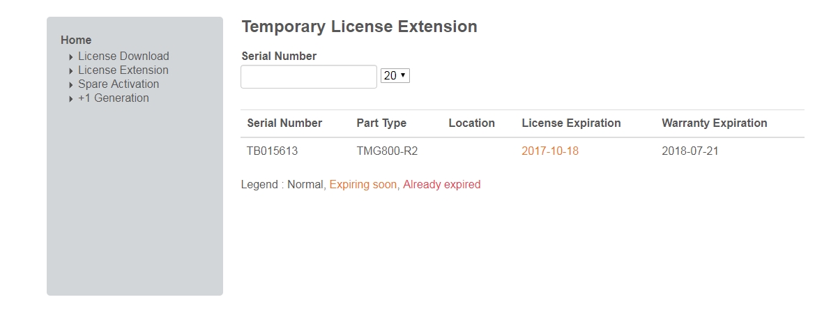

Temporary License extension
1- Either click License Extension or the Extend button.
3- Click Extend. This will extend the license for 10 days.
4- Download the license by following the instructions of "Downloading a License".

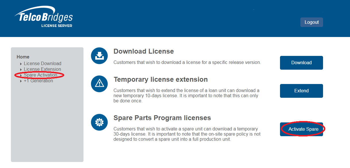

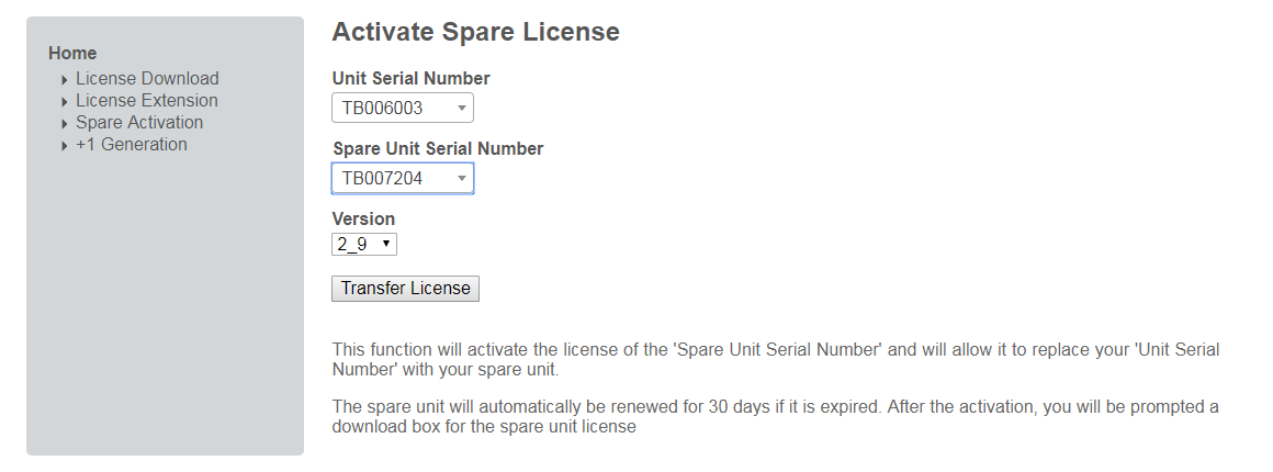

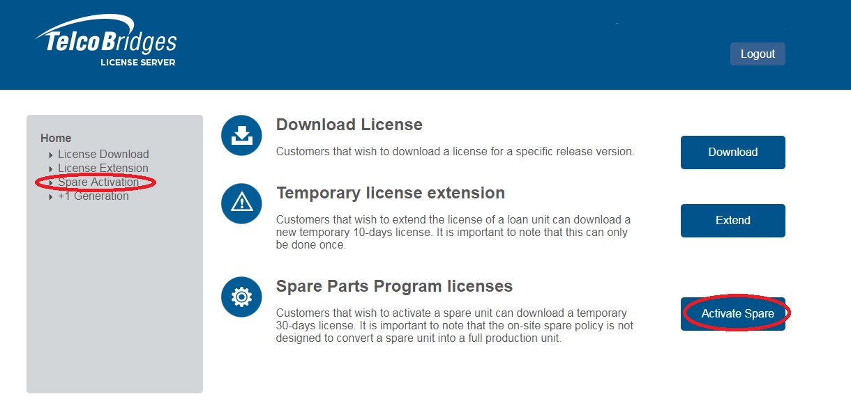

Spare Parts Program licenses
This function will activate the license of the 'Spare Unit Serial Number' and will replace the main unit with your spare unit.
1- Either click Spare Activation or the Activate Spare button.
2- Enter the Unit Serial Number of the device to replace
  • Enter the Spare Unit Serial Number
  • Select your Version from the drop down menu
  • Click Transfer License. This will copy all licensed features from 'Unit Serial Number' to 'Spare Unit Serial Number' and will activate the spare.
You will be prompted for the spare unit license. This license will be valid for 30 days

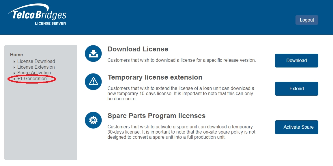

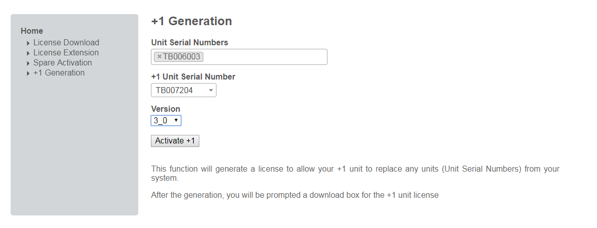

+1 License Generation
This function will generate a license to allow your +1 unit to replace any units (Unit Serial Numbers) from your system.
1- Click +1 Generation
  • Enter the +1 Unit Serial Number
  • Click Activate +1. This will copy all licensed features from 'Unit Serial Number' to '+1 Unit Serial Number' and activate the +1 unit.
You will be prompted for the +1 unit license.
